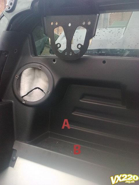

Bulkhead Trim Removal Remove Seats + Top Seat Belt Mounting. Remove Harness Bar if you have one. Remove Speakers. Remove 6 Screws along the top of the trim.
Section B is held down with strong tape. Using a long screwdriver it was possible to get between the tape and the aluminium, then drag it along the length of the shelf to brake the seal.
