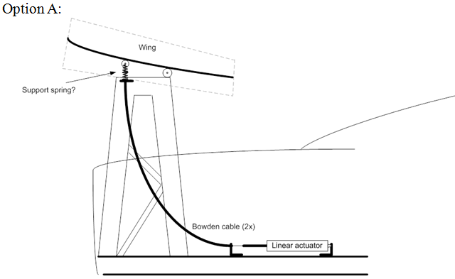

Option A
Option A
  • Option A is easy. Push/pull bowden cable, very simple. Actuator(s) can be mounted somewhere else (low) in the car. The central hinge probably should be somewhere in the middle to minimize forces on the actuator or perhaps add springs to help lift the wing (as on sketch).
