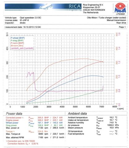

Dyno run on MAHA rollers.
Z20NET engine, balancer delete, lichtened flywheel. Ported head, valve springs, Harrop SC with 80mm pulley, PA pre-rad and a Tullett 2,5 system with decat pipe. Water injection above 1 bar boost to combart the IAT's.
LSJ ecu; road-tuned with HPTuners.
