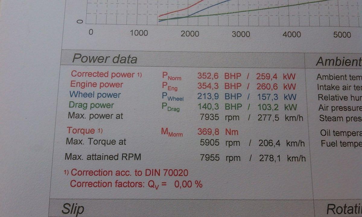

Dyno data from my Oct 2016 MAHA rolling road test. Fitted a 3 inch system (LOUD!)and tweaked the timing on the top end a bit... Dyno roller/rpm reading is a bit off; max rpm limiter was set at 7800rpm. (Log showed 7795peak)
