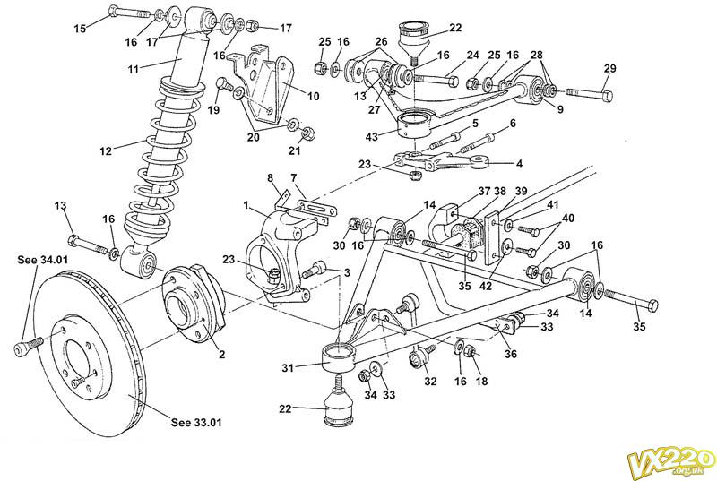

Hub Carrier Bolts #5,#6 SERVICE BULLETIN - Number: 2009/01 Date: January 15, 2009 | Model: Elise/Exige/Europa The bolts securing the steering arm/top ball joint plinth to the hub carrier were upgraded in March '04 at VIN serial number 1537 (approx.). (#5) Bolt, 10.9 grade, M10x40, steering arm to hub carrier A117W7211F x2 | Elise-Shop £1.15 Each (#6) Bolt, 10.9 grade, M10x60, steering arm to hub carrier A117W7212F x2 | Elise-Shop £1.40 Each
Earlier type 8.8 grade bolts should be tightened to 45 Nm; Later 10.9 grade bolts to 68 Nm. The bolt grade is stamped around the head of the bolt.
The thread of both bolt types should first be thoroughly cleaned before treating with Permabond A130 (A912E7033V).
