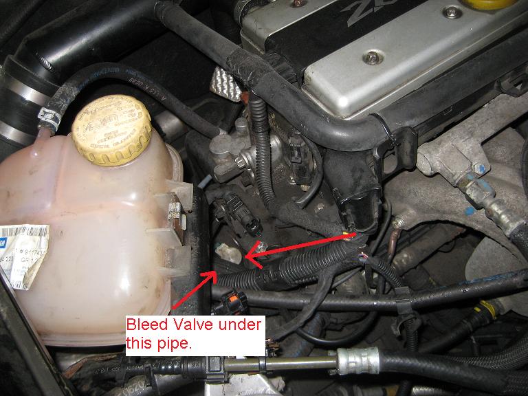

Its wise to bleed the clutch after the brakes.
Into the engine bay, ontop of the gearbox is a nipple.... same procedure as brakes, done.
