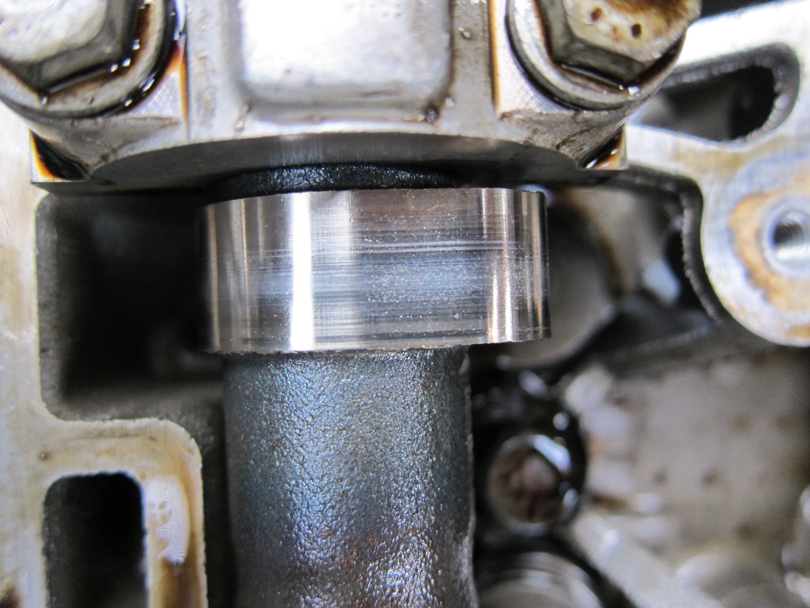

so I had a quick look under the rocker cover today...

There's pretty bad cam wear.
All the inlet cams are pretty worn, with most of the hardening removed - all cams show linear wear scares suggesting some entrainment of abrasive matterials and three cams showed pitting, including the one in the photo.
The fact that this engine has an oil leak around the cam cover and that there's rust on the cams makes me think that it's because of oil starvation.

Not exactly - I took the rocker cover off this evening because i've had an oil leak from the cam cover and wanted to see exactly where it was coming from - i'm changing the oil tomorrow so it seemed a good time to look.
The photos don't capture it very well but it's one of the worst cams i've seen. The pitting does make me worry because that's implying the hardening has been completely worn from the cam and they are now similar hardnesses - the pitting will continue to happen at greater rates, dumping metal into the oil causing further wear and finally failure. I'd be happy if it wasn't for that, but 3 of the inlet cams are showing pitting.

What kind of mileage ? It's cam wear yes, roller followers to not completely remove cam wear unfortunately, but if we're speaking of a 100k+ engine, looks perfectly normal to me...
Just ticked over 70 k, although i've only had it for the last 15 k - i've got service history but that doesn't show how regularly it was driven or how it was driven.

You're right, narrowing of the cam (this can usually been seen comparing the side taper to the taper on the side of the cam tip, they are the same when new, but cam tip wears flat so no taper - this results in a loss of power, but no real engine issues.
The pitting is a mode of failure though - the material that's removed from the cam or tappet circulate around the engine as a 3rd body abrasive, causing liner scoring, further cam/tappet wear, blocking oil channels or the oil pickup, increasing filter pressure. wear metals also act as deposit seeding points which causes piston deposits.

As others have said, I think thats normal wear for an engine of your milage. If you blue-printed/measured the actual wear from OEM spec I would be surprised if it was more than 0.1 mm, which is trifling really. For example you piston rings will probably accomodate several times that amount of wear without issue.
