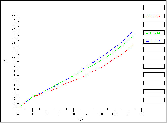

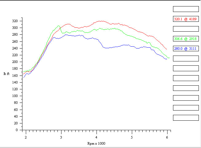

If that's got the TMS chargecooler then adding it should take it to stg4 my old VXT started life as a TMS stg 4 that was reworked by courtenays some more details
I find these figures highly amusing.I run stage 4 tms and my graph showed max 255bhp.I think its high time tms and courtneys go to a rolling road shoot out,middle ground rolling road,Any body else agree?
:9mm:
We've had a TMS4 on our dyno that read 255.1 bhp and 280 lb ft torque......... So in line with what you've been given.
The same car we then mapped with our Stage 4 software which is different to TMS software and the same car on the same dyno on the same day produced 269 bhp and 306.6lb ft torque
The reason the figures aren't as good as the Courtenay Stage 4 is there is a restirction the in the OE intercooler/charge cooler set up........
A VXT mapped on our software with our new cooler full Milltek, VXR turbo, VXR injectors and uprated actuator (not the VXR actuator) produced 292.4 bhp and 320.1 lb ft torque on our dyno due to the less restictive charge cooler set up. Also we are able to change the injectors and remap accordingly which gives us additional fuel in reserve under extreme conditions such as track days where inlet air temps will be hotter so we have additional fuel in reserve..... Anyone on ZLET injectors on a Stage 4 will find they are maxed out at 25.3 Ms through most of the rev range.... meaning they cannot flow anymore fuel......
We're not trying to force the peak headline bhp figures as we all know that different dyno and different day will produce different results and we're not trying to suggest anyone's dyno is more or less accurate than anyone elses but
Look at the difference between the graphs i.e. the gains through the mid range. These gains can only be achieved from using bigger injectors which enable us to sustain the overboost for longer because we are not maxing out the injectors. This is where the big improvements come from in terms of on road driving........
Also look at the acceleration figures which are take from the dyno run 40 to 124.3 mph in 16.7 seconds on TMS4 vs 40-124.4 in 13.7 seconds for the CSS4...... These are from a dyno run but cannot be 'altered' as the load is pre-set.
We're happy to show these results to anyone else on their own cars.
Here are some graphs for illustration........
RED = CS4 on Courtenay Charge Cooler GREEN = CS4 map on OE Intercooler and Chargecooler set up BLUE = TMS4
Alternativly there is now MMG, just so noone can say I'm bias
Edited by Winstar, 17 April 2012 - 04:41 PM.
