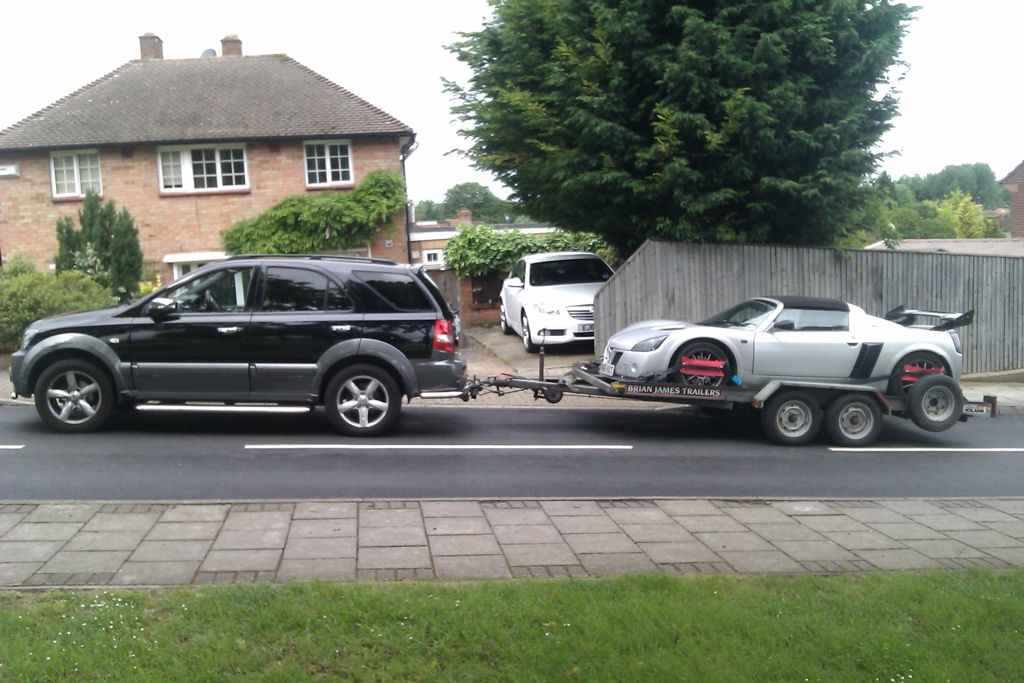

#16 mbes2
mbes2
    Someone say Plasti Dip?
  • 8,516 posts
  • Location:Feering, Essex
    "Yes, I built it"
Posted 05 November 2012 - 03:02 PM
Never seen a trailer that comes apart....
Best thing Ive done for the VX for track days.
(this was a test photo, as the VX now goes the other way around on the trailer)
