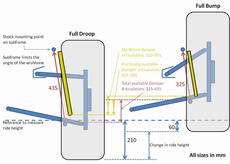

OK so thanks to Scuffer's tests we have found there are some issues with a number of VX220 Nitrons.
It seems that Nitrons NTR 40mm's that were supplied in the TMS spec, some pre 2009 Nitrons and some custom builds are quite short (open length of 395mm).
Nitron 46mm shocks are not effected by this issue
There is no safety issue and the shocks perform very well however the stroke window does not match the fairly tight articulation window of the wishbones.  Some shocks are too short.  Bump rubbers were introduced to limit this to prevent the short closed length causing interferance between the wishbone and subframe but there is stroke wasted here which is then also lost in rebound as the short open length of the shock limits the rebound.  Alexb's pic illustrates this well.
Many people have had these shocks for years without noticing and there has not been any actual complaints for this issue but it is a good idea to try and optimise this to unlock the full potential of the Nitron shocks which remain very good.
Ok so doing some calculations
Overall wishbone articulation = 435 open 325 closed.
So dead centre of the articualtion stroke = 380mm
Most people drop the ride height by about 15mm so damper to wheel ratio of 1.35 means you'll take 11.11mm from the damper.
So your damper would be set at 368.9mm to achieve around -15mm ride height.  Split the 80mm stroke 60:40 (rebound/bump) and the shock limits are ideally 416.9mm and 336.9mm (for this stroke length).
Current spec actual length
NTR40's
Open length = 411.5mm
Closed with bump stop compressed = 331.9mm
NSS
Open length = 415.3mm
Now to be 100% perfect the Nitron NTR shock would have it's rebound/bump window shifted a further 5-10mm or so (longer) but this just pure optimisation and not actually necassary.  I will pass this on to Nitron though once I confirm the figures and request that they change the spec of VX220 dampers to reflect this research.
The problem seems exists in earlier spec shocks which were supplied by tuning companies around 2009.  These seem to have a short open length of 395mm and a closed length of around 310mm.  This closed length has been limited with rubbers so the actual available stroke is now very short and the lower the car's ride height is set the less bump is available before wishbone contact.  Additionally there is not alot of actual rebound either (35-40mm at the wheels at around -15mm ride height).
Now we are looking to judge the demand for an engineering solution for this.

[font="Arial, 'sans-serif';color:#222222;font-size:10.5pt;"]OK so we've been working with Nitron on optimising the current NTR spec shock and we're happy now that the standard spec VX220 NTR 40's has been improved.  They will have a more robust solution to the closed length issue which has now been limited to an absolute closed length of 325mm which will ensure no contact wth subframe at maximum bump.  A bump rubber will remain in place.[/font]
[font="Arial, 'sans-serif';color:#222222;font-size:10.5pt;"] [/font]
[font="Arial, 'sans-serif';color:#222222;font-size:10.5pt;"]As for the open length this too will be increased slightly to around 417mm which (from typical ride heights) will offer more droop than Lotus designed the standard shocks with.  Exact figures not to hand but looking at around 70-75mm which is plenty (even for a road car).[/font]
[font="Arial, 'sans-serif';color:#222222;font-size:10.5pt;"]All damping is within the articulation of the shocks.  Only concern currently is springs as this may render the requirement for a helper spring to be used which will inflate the cost of this kit....[/font]
With regards to the old spec 395's etc.....  I would like to know your thoughts on these suggested solutions....
[font="Arial, 'sans-serif';color:#222222;font-size:10.5pt;"]You have a few options available so contact me if you want to go ahead with any of the options below.....[/font]
1,  We can return your shocks to Nitron who will modify your shocks to put them in line with current spec shocks.  This will move the stroke window to within the wishbone articualtion window and improve your droop significantly.  This will cost £50 +vat
[font="Arial, 'sans-serif';color:#222222;font-size:10.5pt;"]2.  We can book your shocks in to Nitron for a full refurb (£65 per corner + vat) during which the shocks length will be modified free of charge.  They will be updated with the current 2013 spec internals and will come back in 'as new' condition.[/font]
