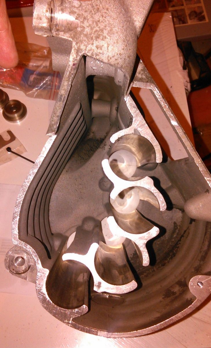

inside pic of our SC manifold:
For access (change of nozzles...) and an even distribution I would say 2 nozzles from the sides (but alternator there is not easy), both spraying into the widest area after the laminova cores.
Or spraying from the bottom upwards, but then the lower mounting point is in the way. Maybe 1 jet spraying upwards from the centre, or 2 smaller jets mounted fairly central but angled a bit outwards?

Good pic that. Hell of a sacrifice though. :wacko:

Great pic 👍
#68 The Batman
Posted 11 November 2015 - 02:15 PM
There is another reason why he cut it ;)

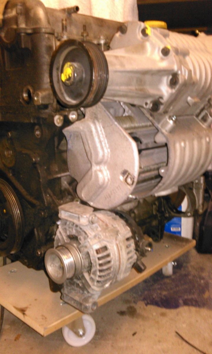

Crabash, on 10 Nov 2015 - 04:47 AM, said:
Needs to be lower to miss the alternator. Very tight on that side. Don't waste your time doing it on the cheap (boost control), control via fuel inj signal, kits cost more but better than a kit at half the price that is a dead weight.
I,ve not seen one that works better than Acidpopstars and I put it down to position of nozzles and the way it's controlled. I have tested an extra jet before the SC, there was no diff to min temps, there may be some improvement to the max temps after prolonged running, I installed jet to give us the option.
CHILL Gone DUTCH, on 11 Nov 2015 - 1:52 PM, said:
I was thinking of putting one injector on the Harrop where the spare map sensor or plug normally goes to help the air before its compressed and then 2 injectors after the laminovas as exmantaa suggests
We injected before the throttlebody, so pre-charger and that not do much for lowering IAT's on track. :dry:

#71 smiley
Posted 11 November 2015 - 03:35 PM
I believe that picture is from 2014.
Any development?
#72 Exmantaa
  • 3,982 posts
Posted 11 November 2015 - 04:08 PM
Nop... hopefully coming winter.

Posted 11 November 2015 - 08:39 PM
We did it after TB and same result, but we had 2 jets in the right place already doing a good job so was unsure if it was having any effect, pre SC can raise efficiency and keep the SC it's self cooler, we noted this but no diff to power or IAT.
