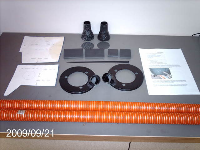

Does anyone have any pictures of how the duct is connected to what was the fog light holes?
#67 techieboy
Posted 17 July 2014 - 09:05 PM
Ducting is fitted to a fibreglass reducer/adapter that is bonded to the return edges of the fog light recesses.
The two kind of bell shaped black things at the top centre of the pic
Small bit of mesh/filter is inserted into the fat end of the reducer, the fat end then slips over the fog light recess return and is bonded in place with Tigerseal/whatever. You can't really see anything once it's all fitted - other than a lack of fog lights. The reducer is hidden between the clam and the rad shroud.

So they are bonded on, cheers Matt. I don't suppose anyone has just the reducers up for grabs? Matt you must have at least 6 of these kits, no?

Fcuk that. The pain of removing the fog lights and fitting the reducers first time around means that was a one time deal. :wacko:

Yeah. Removing the fog lights and their brackets through the headlight aperture is a piece of p*ss isn't it? Nothing like the worlds hardest games of tetris. Even more fun getting a source of heat in there to shrink the heatshrink that joins the ducting to the reducer.
