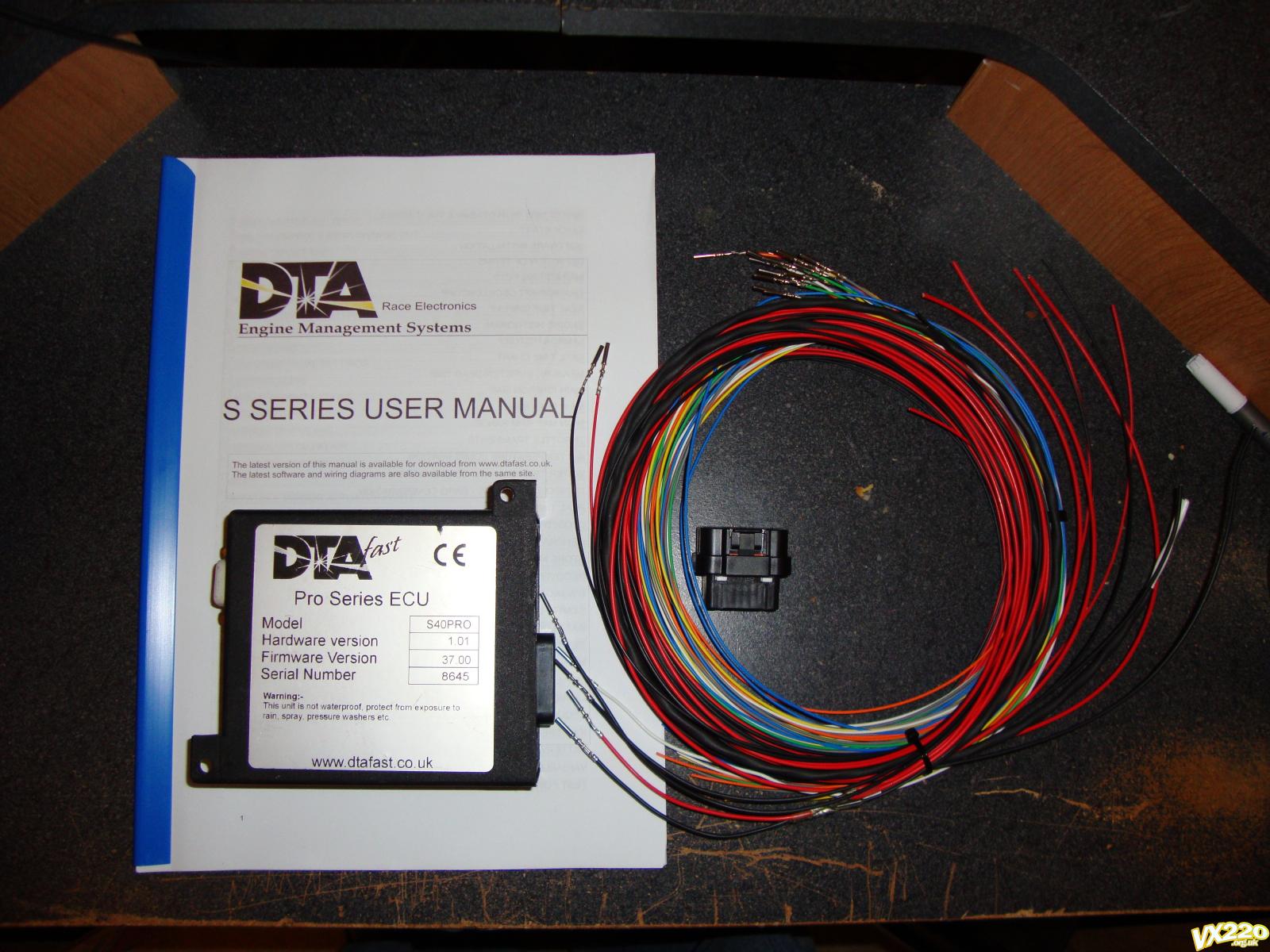

This is my next project as the z22se ecu is still not cracked so looks like I need a standalone to get the best out of the car,
I got a DTA S40 along with a loom but JUST need to put them together.
so watch this space...
anyone done a z22se loom before?

I know this might be a tad late considering Ibrought a DTA and am getting all the stuff needed for it BUT that EFI looks good, I am trying to find out if it has FBW.
Would save me a load of hassle

Thia was the reply from Chris at EFI
Hi Nick
Not many ECU's can control FBW, and the Adaptronic cannot either unfortunately, so a cable throttle would be required.
Yes, loom is possible but I need to have access to all of the engine's sensors, or if that isn't possible then data sheets on the sensors you are using, so that the loom can be made with the correct connectors and the correct wiring, etc. Also required dimensions (lengths from ECU to each sensor) is required.
Yes, 7-1 should be no problem, as long as the trigger has 6 evenly spaced "teeth" with one missing. The ECU can accept either digital (hall sensor, optical, etc) inputs or the more common VR (variable reluctor, magnetic) type of input. Alternatively, a simple 36-1 wheel on the bottom crank pulley with a universal sensor will work fine.
Regards, Chris
"The 6 evenly spaced" won't apply to use then so still an external wheel required. worth an email though
very easy to knock that up thumbsup
There is a little package on it's way it hold a load of cable and an plug, could I please have it back fully made up :lol:
Thanks seriously Neil, I am about to order all the connectors, + realise I called the crank a 7-1 rather than a 5+2 either way still don't think it will work with the OEM wheel. :( I should have sent him a picture instead..
