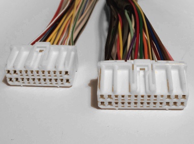

ECU is Adaptronic and Zac went for the 440 - spec below;
The Adaptronic 440/Select ECU and 2m bare loom package
The 440/Select ECU is the full-featured progression of the 420d model. It is a logical progression of the older e420c model; enhancements include more RAM for future firmware updates, faster proccessing, USB (and RS232) connectivity, a headphone jack for knock monitoring and a list of new firmware features.
Users of the 420c or 420d will be pleased to hear that the 440 uses the same intuitive "WARI" software as before. The 440 will accept map files created for the 420 with only minor additional settings required, therefore upgrading from a 420 is a quick and painless procedure.
Just like the 420, the user can use as few or as many of the ECU features as they want. If you're a novice, don't let the ECU's long list of advanced features put you off! You can simply ignore what you don't need right now and be happy in the knowledge that those features are available should you want them in the future.
Main features include:
  • "3D" Fuel and Ignition maps (as on any sophisticated aftermarket ECU)
  • Configurable ignition and injection outputs to suit different applications
  • Up to 3 VR or digital crank and cam angle inputs
  • Inputs for water temperature, air temperature, auxiliary temperature (eg turbo), external Manifold Air Pressure sensor, Throttle Position Sensor, knock sensor, EGO (exhaust gas oxygen)
  • Internal MAP sensor suitable for up to 40 psi of boost
  • Outputs for four injector groups - allows full sequential injection up to 4-cylinders, or semi-sequential injection up to 8- cylinders
  • Outputs for four igniter groups - allows full sequential spark up to four cylinders and wasted spark systems up to 8-cylinders, or any conventional distributor systems
  • Eight configurable auxiliary outputs - four of which are configurable as high current outputs, three of which are PWM capable
  • Eight configurable digital inputs
  • Numerous diagnostic LEDs, including LEDs to indicate trigger input detection and injector/ignition outputs
  • 3.5mm headphone jack for listening to knock
  • PC interface via USB cable
  • Field upgradeable firmware
  • Datalogging via 'WARI' PC software
  • Free support by forum, email and phone
  • 12 month 'return to base' warranty
  • Adaptive fuel control - with configurable tolerances and loop gains, and conditions under which adaptive behaviour takes place
  • Narrow-band (factory EGO sensor) closed loop fuel control
  • Flex Fuel control (requires fuel composition sensor to be fitted)
  • High current programmable outputs - allows direct drive of solenoid valves for boost control, air bypass etc
  • Special function programmable outputs - allows control of anti-pollution purge valves, air conditioners etc
  • Open-loop and closed-loop idle bypass control - allows configuration of increased idle bypass amount based on low battery, electrical load, air conditioner, as well as correction based on RPM, optional ignition timing control for idle speed regulation
  • Programmable for many different crank/cam angle sensor waveforms
  • Open-loop and closed-loop boost control
  • Dual closed-loop variable valve timing (VVT) channels
  • Traction control and launch control (2 step)
  • Boost control by gear (gear detection inbuilt)
  • Pit lane speed limiter
  • Dimensions, excluding mounting tabs - Width x Height x Length (mm) is 102 x 32 x 125
    Rear panel with OEM quality connectors:
    Included 2m long bare ended loom:
