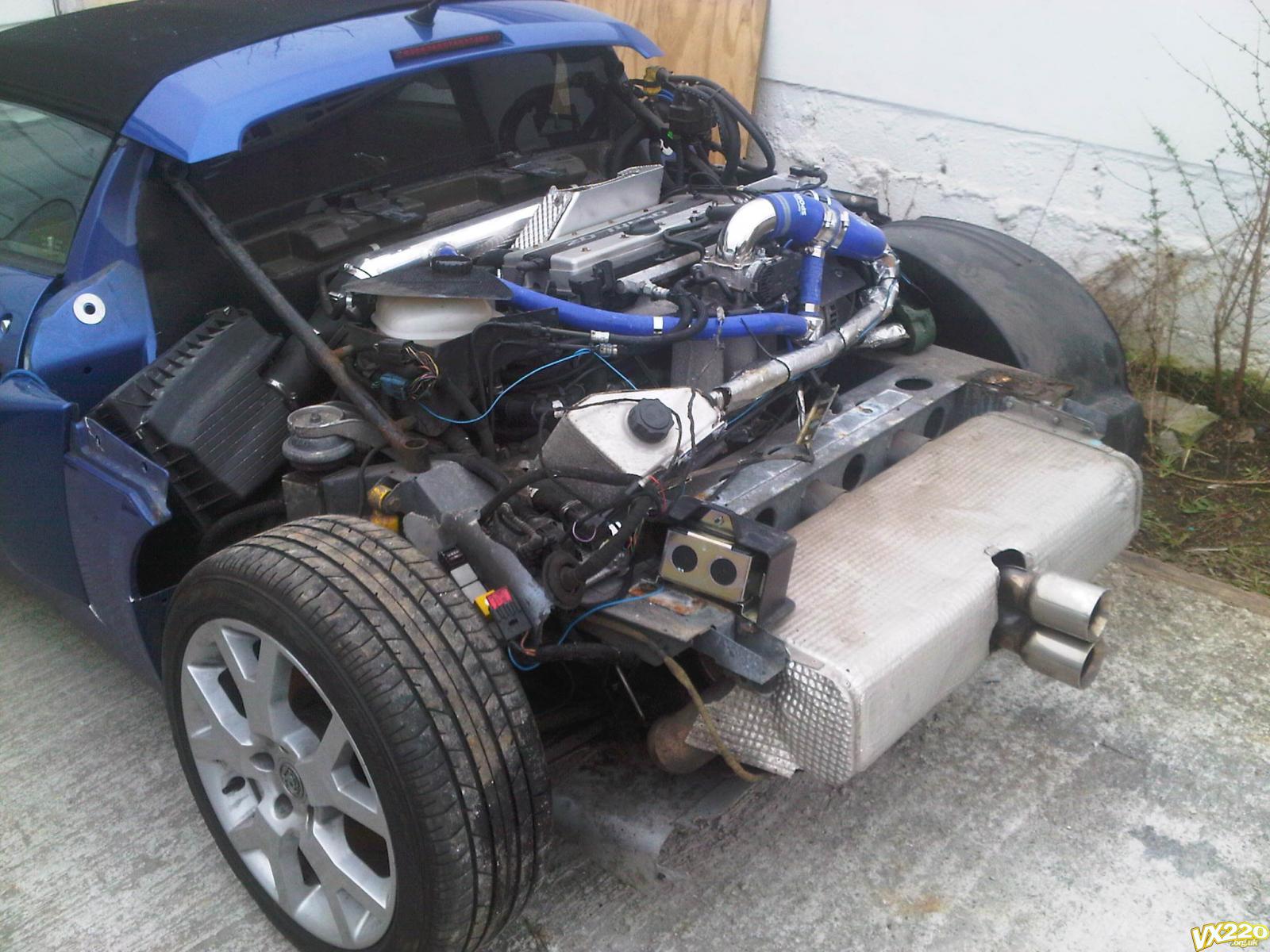

After all the help i got on here putting my vxt back on the road i decided to buy Zoobeefs old car off him after his accident last year and return it to its former glory and possible take it to stage 4.
here are a few pics of where i have got so far.
arrived but wont start :mellow: got an auto electrician comming tomorrow afternoon so hopefully we can get it running.
couldnt bare to uncover the rear
I can feel the cars pain...

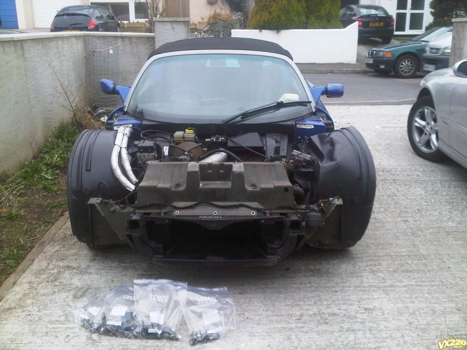

So with the help of my nephew we started on the front removing all the damaged bits.
Looks so much better already. No damage to the crash box and the radiator surround almost got away with it too.
Ive noticed there is a little bit of trim on the wheel arch which i didnt have on mine, so far no one knows why its there, if anyone knows of its origin and where i can get a replacement i would appreciate it.

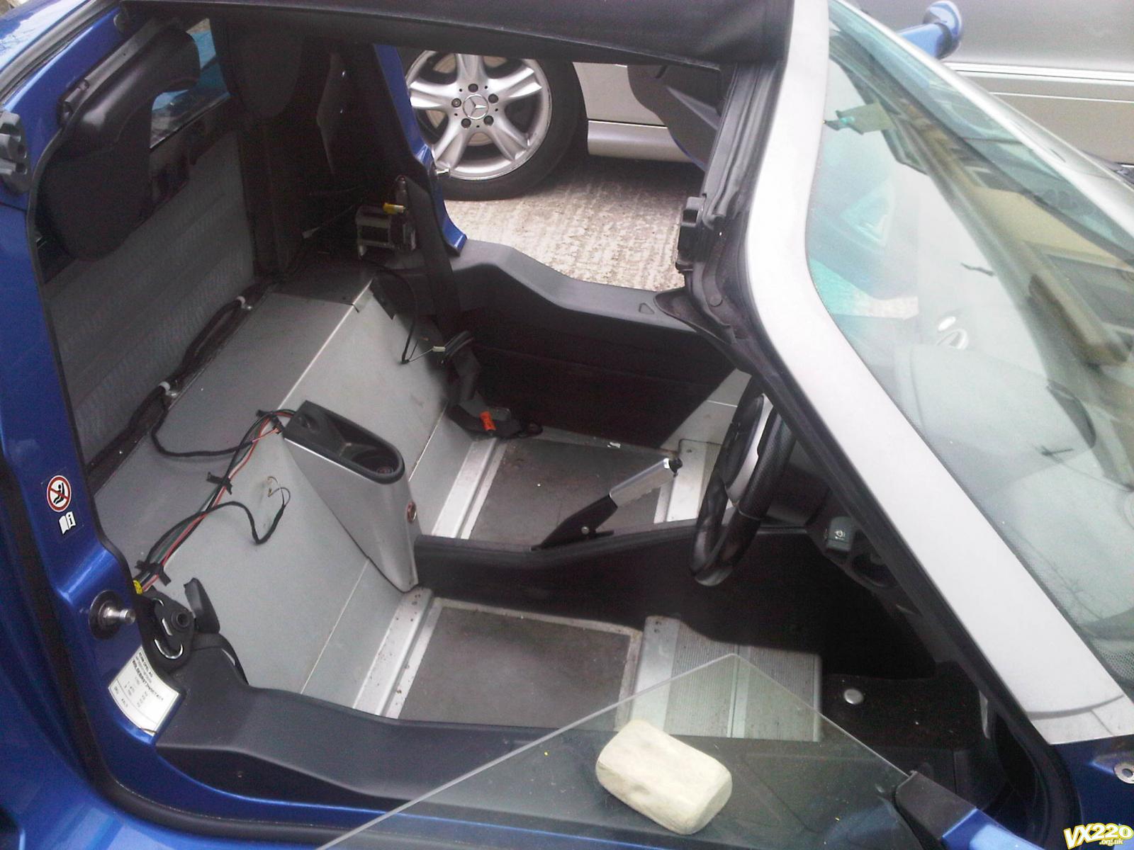

next up was to remove the interior so we could get at the rear clam. I noticed some little right angle bits under the rear of the seats which i missed on mine, anyone know why these are there? i still have mine left over from my last build.
#4 techieboy
Posted 06 March 2011 - 02:49 PM
They go in the ends of the drivers seat runners to stop the seat going to far back and coming out of the runner altogether.

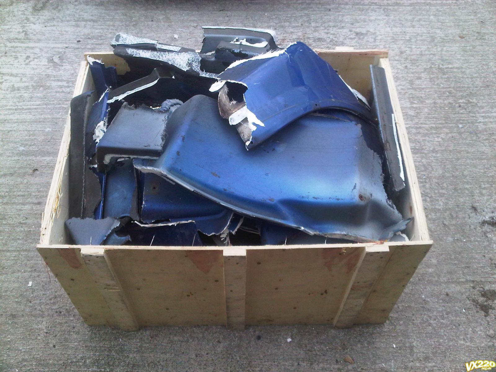

Next up was rear clam, much helped by the fact most of it was removed by the accident so some of the hard to reach bolts were accessible with ease, i would like to use stainless bolts on here when it all goes back together though. i can see that being a good upgrade for future work.
Suprisingly both the front and the rear clams fit in this little box :blink:
Kinda makes you think how fragile the body is...
Well this is as far as i can go today, waiting for some bits to arrive, hopefully tomorrow i can get the rear toe link sorted and the engine running again. :)
Cheers mate, my amp stops the seat as i push it back to get out so thats why i never found out where the go thumbsup

Posted 06 March 2011 - 03:47 PM
An alternative view is the fibreglass has done a great job of absorbing the impacts with next to no damage to the structure of the car or drvetrain. Looks like a great project and a major bonus that you'll get this back on the road with a couple of new clams. I was expecting to see some damage to the front crash brox or rear subframe after seeing the photos after the crash.

Posted 13 March 2011 - 10:19 PM

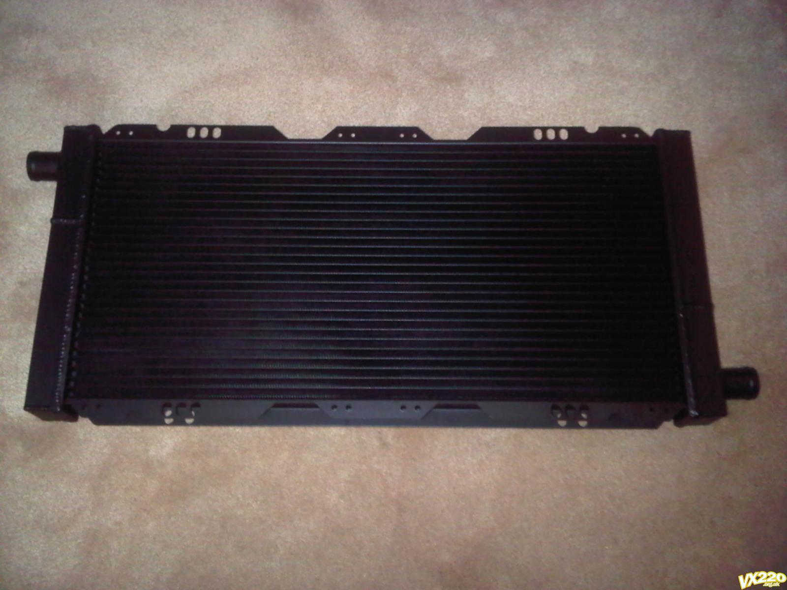

Got a bit further today, spent ages trying to remove the undertray allenkey bolts as one was rounded off, only to find the sides had been grinded down to accept a spanner.. I got the old track rod off with a bit of jiggling and replaced it with one from ElizP987, many thanks thumbsup , now i can move it around, had to take it down the road to turn it around obviously ;) It does sound lovely :wub: Just ordered a triple pass radiator. now i either replace the rad surround or reinforce the broken corner, still not sure what to do? the MVS ones are ok but not like the original. roll on next weekend

Posted 15 March 2011 - 06:51 PM
One new radiator :)
